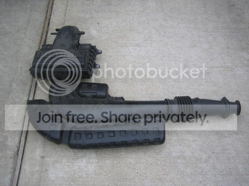

    This isn't mine but it's the stock intake with the 3 chambers and no Gotts mod

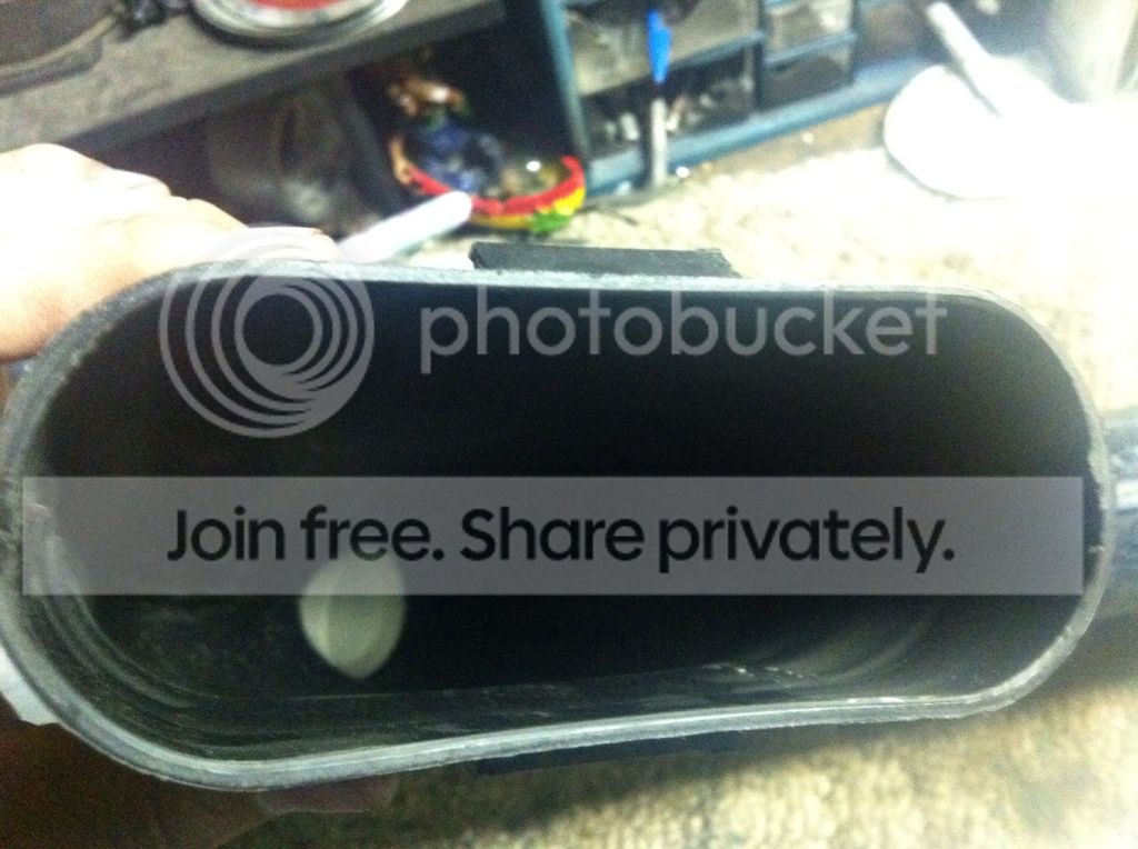

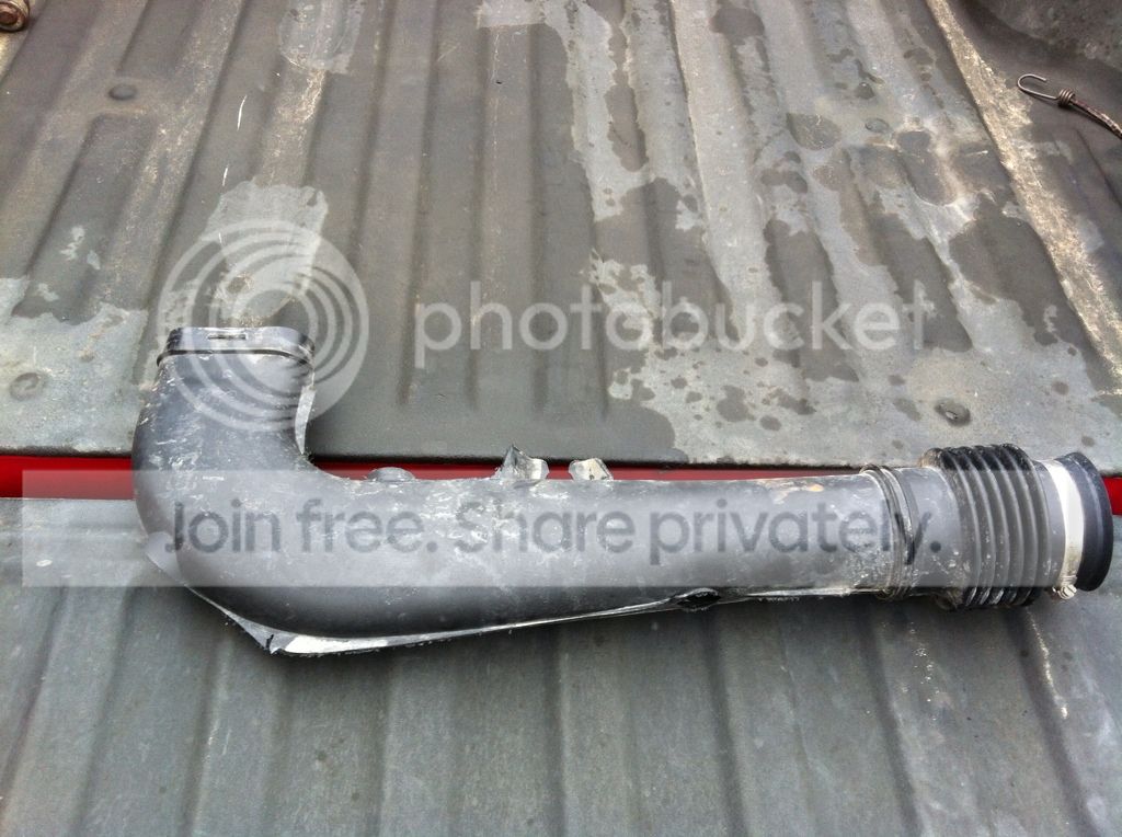

    Step two is to cut the chambers off. Be sure to leave enough of the holes to be able to plug them. I accidently cut one of mine all the way down so it made plugging the hole a little harder.
    You should get this:

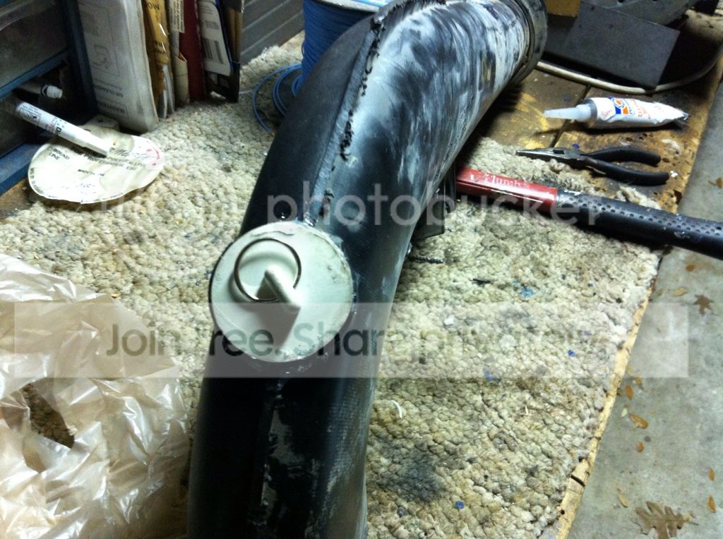

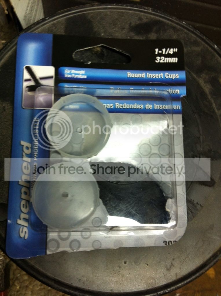

    Next step is getting something to plug the holes with. two of the holes measure 1-1/4" ID and the bigger hole measures 1-5/8" ID. I took a trip to home depot and found a perfect 1-5/8" sink plug and some 1-1/4" plastic plugs

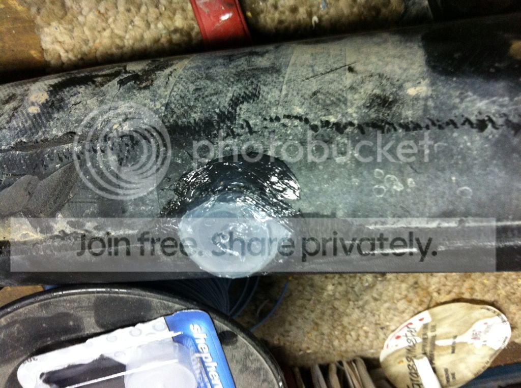

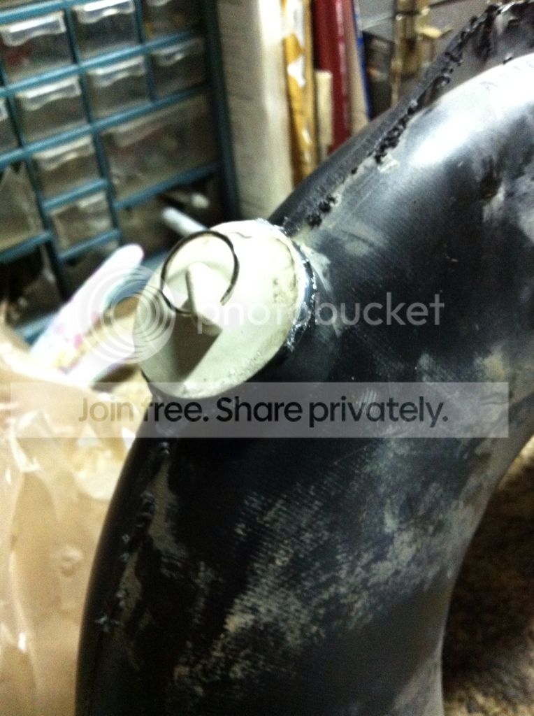

    Next is to put in the plugs into the 3 holes. I also applied clear silicone around the edges to make sure it wouldn't leak air.

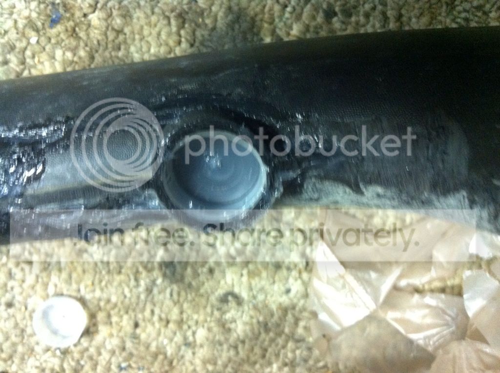

    The accident hole

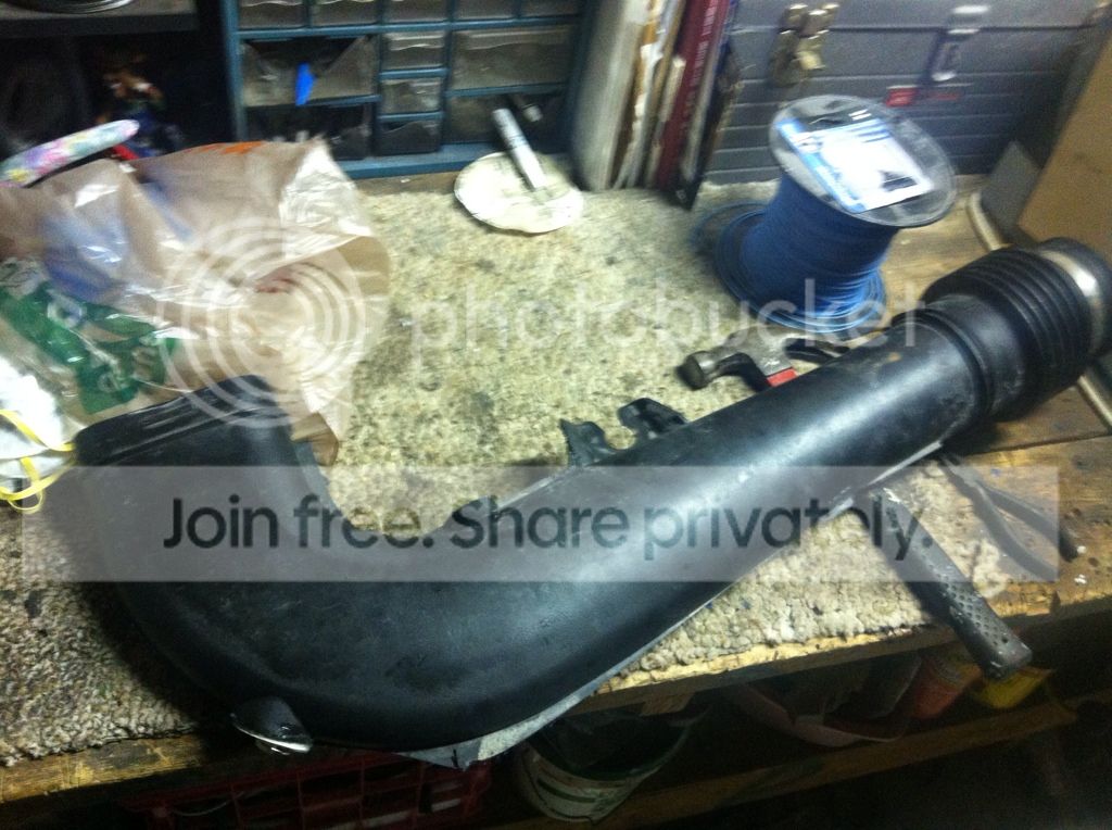

    And you're DONE! ..lol

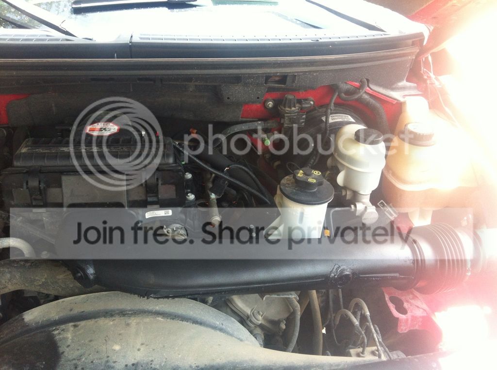

    Get some black spray paint and paint the intake and slap it in.:peace:
