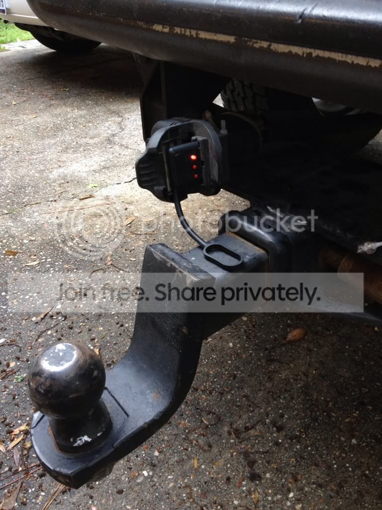

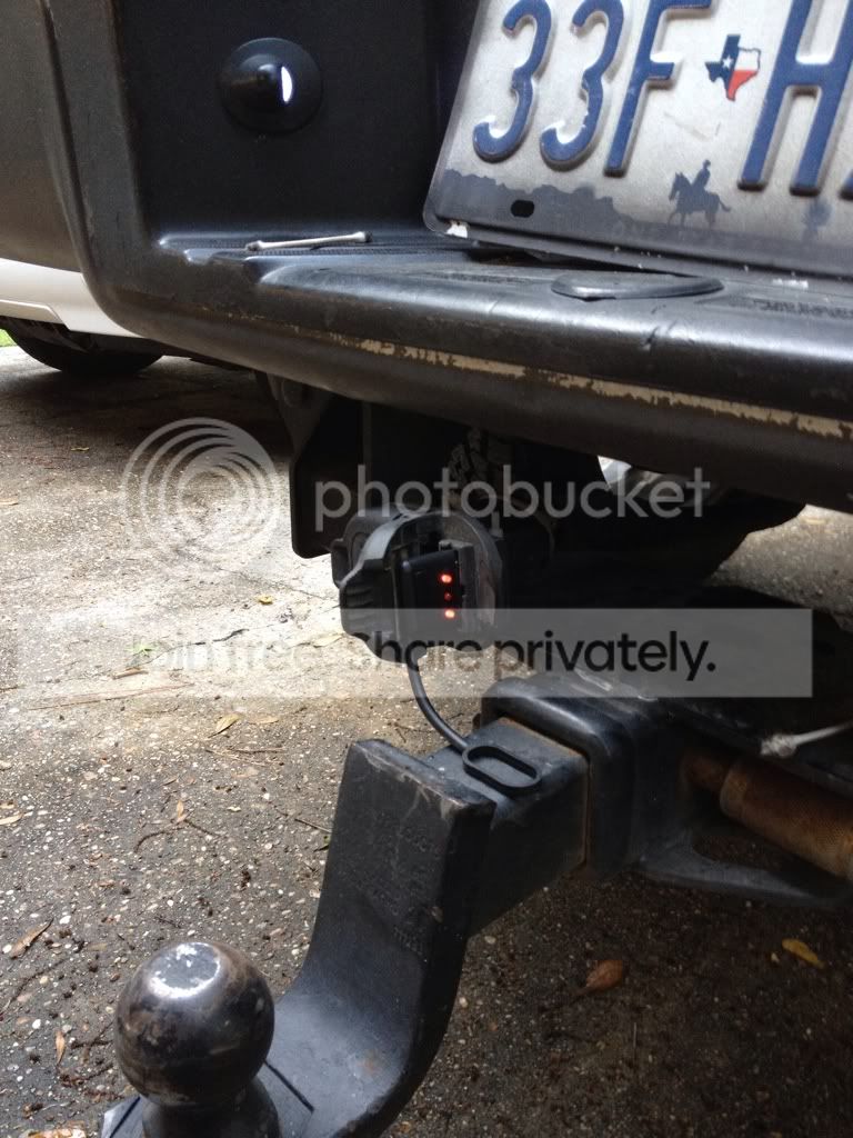

    Im checking fuses. No manual at hand. 5 pin relay is good. The 'tail' indicator on my trailer tester is lit up.
    Fuse 10 & 14 were good. Found somewhere to check fuse 36 and that was blown. Replaced it and now the Rt indicator flashes on sync with my tails.
    Is there another fuse for the left trailer tail like the right had fuse 36? Thanks in advance!
