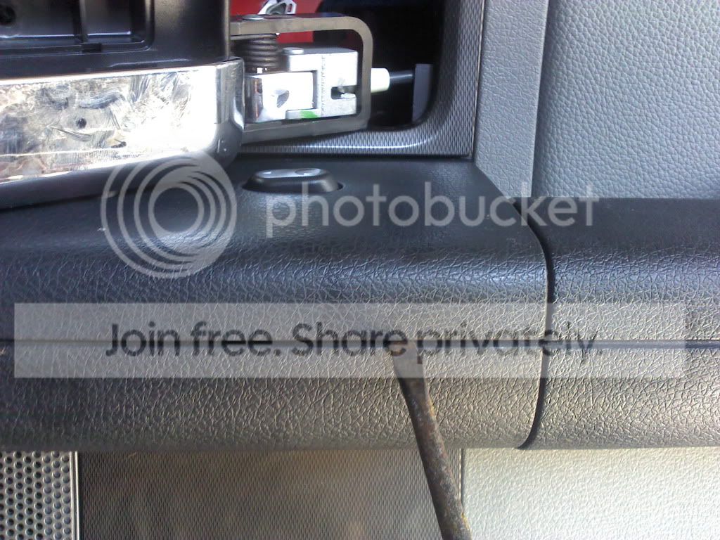

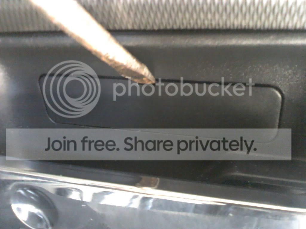

    Step #1: Behind the door handle there is a latch that you pry open with a flat head

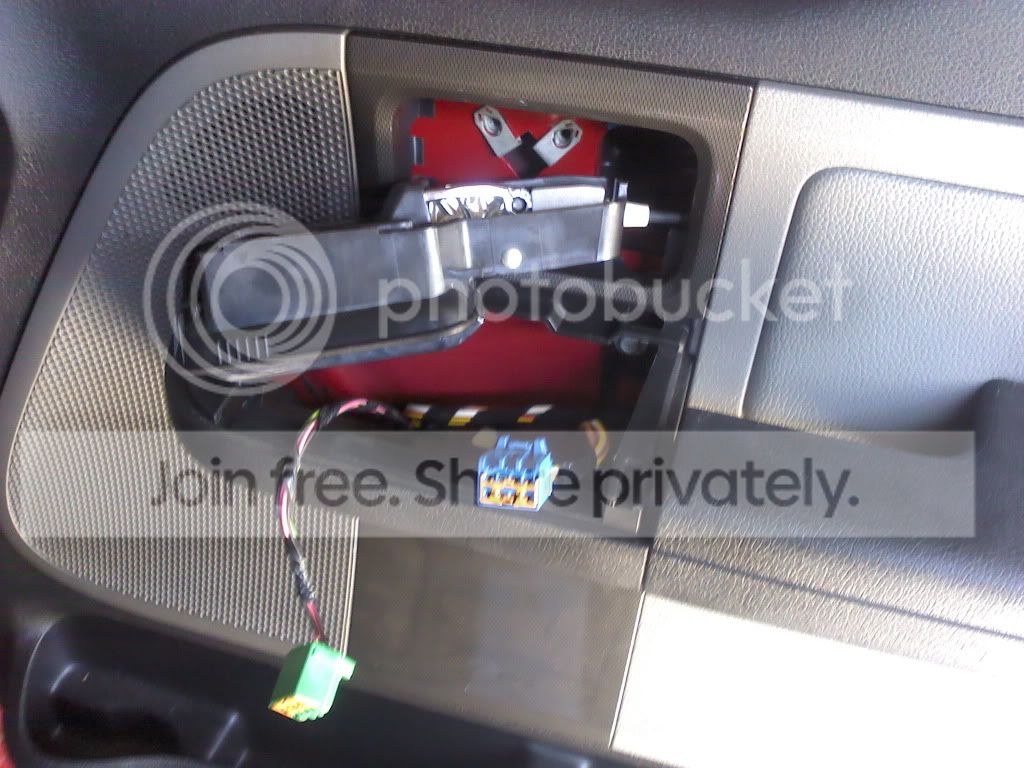

    Step #2:Remove the two screws behind that(8mm)

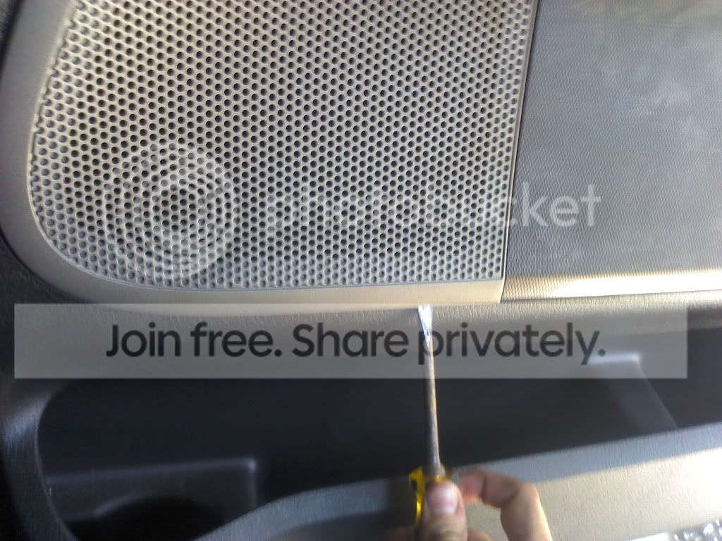

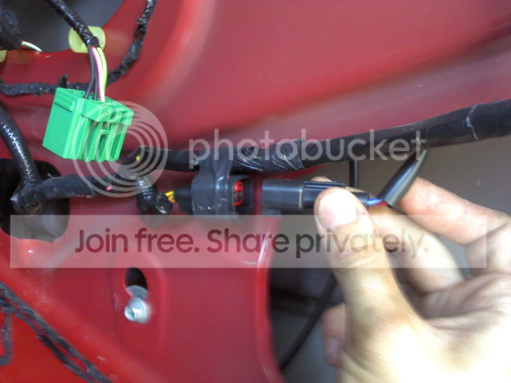

    Step #3: Pry the window and lock pad off and disconnect the harnesses

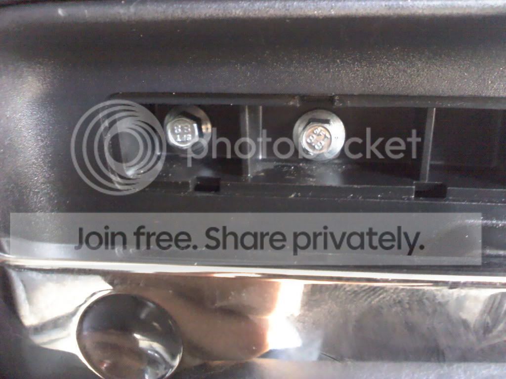

    Step #4: Right below the hatch there is a bolt holding the panel on(10mm)

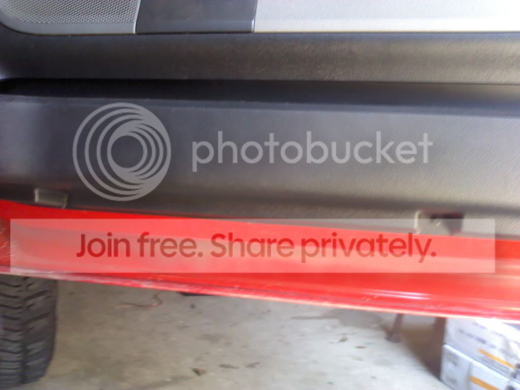

    Step #5: At the bottom of the door there are two screws(6mm)

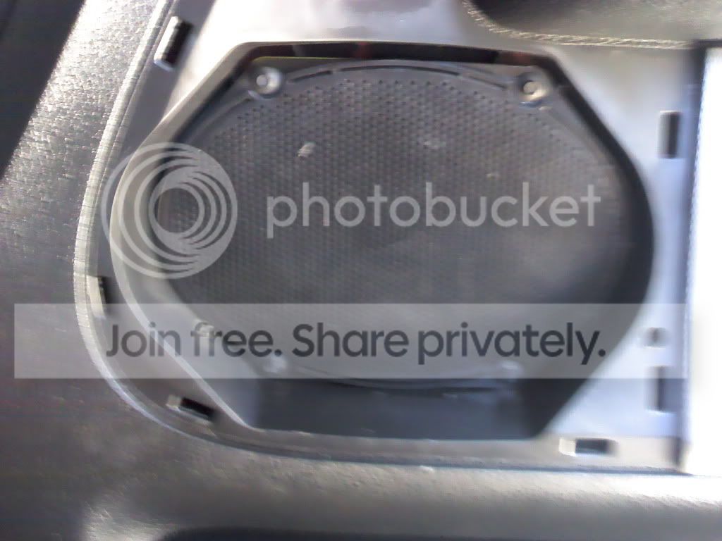

    Step #6: Remove the speaker cover

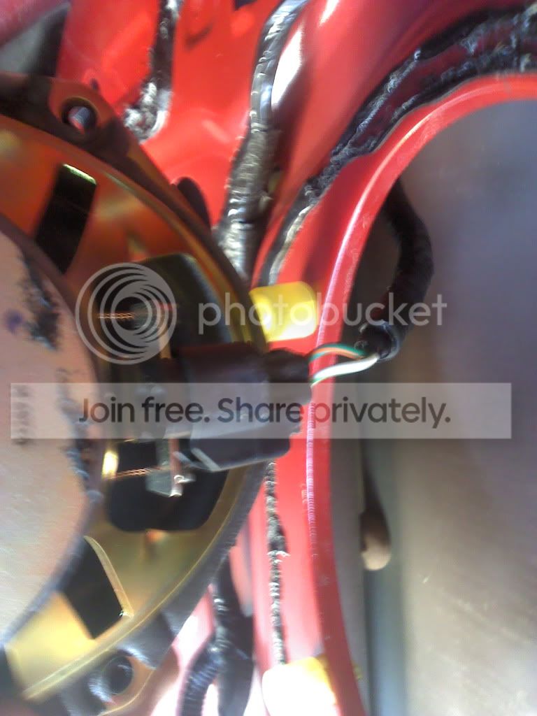

    Step #7: Remove the 4 screws holding the speaker(5.5mm)
    Step #8: Disconnect speaker

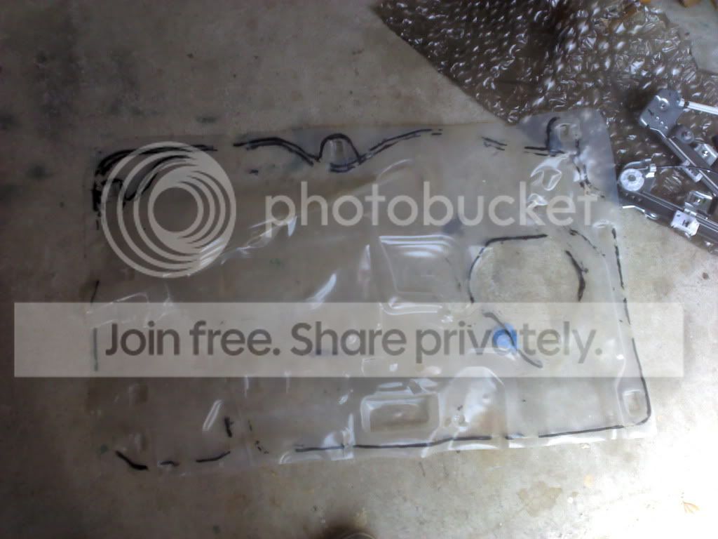

    Step #9: After everything has been disconnected pull up on the door panel and it should come off, there will be a giant plastic cover over everything which you'll need to take off.

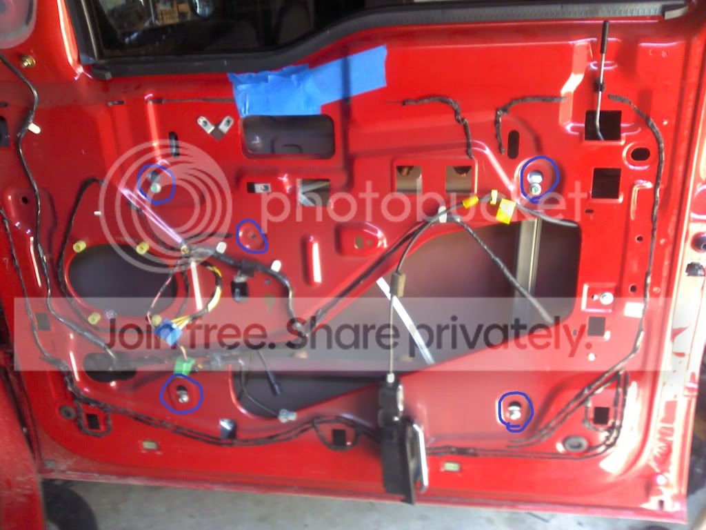

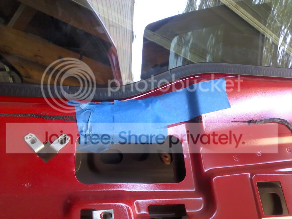

    Step #10: Push the window all the way up and tape it like so to keep it up

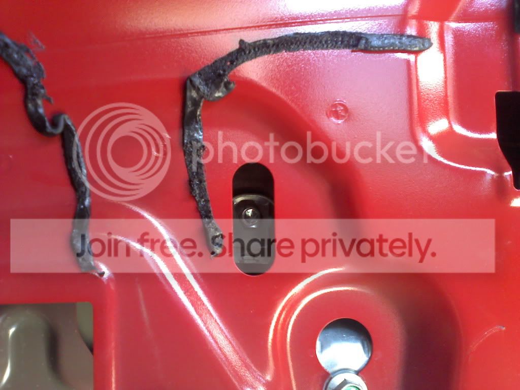

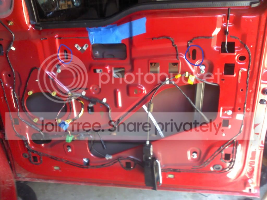

    Step #11: There are two vertical slots on either side of the panel that provide access to the two clamps which hold the window(10mm)
    Step #12: after the clamps have been loosened it's time to take the assembly out. There are five bolts, four that hold the "tracts" and one in the middle that holds the motor. You should be able to collapse the assembly and take it out of the giant hole of the panel. Don't forget to disconnect the motor from the harness

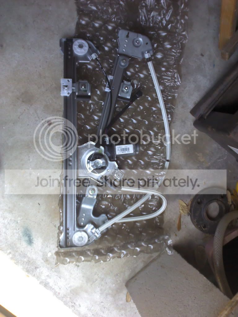

    Step #13: get you a new assembly. I picked mine up at the local Ford dealer for just about $132
    Step #14: spread the assembly out like an "H" making sure the motor is on the left. Also make sure the threads to the bolts are facing up and it's not upside down.
    Step #15: Get eveything lined up and tighten the bolts down and plug the motor into the harness
    Step #16: plug the window switch harness in, turn the key on and roll up the window up all the way until the clamps cover the glass and tighten the two bolts completely.
