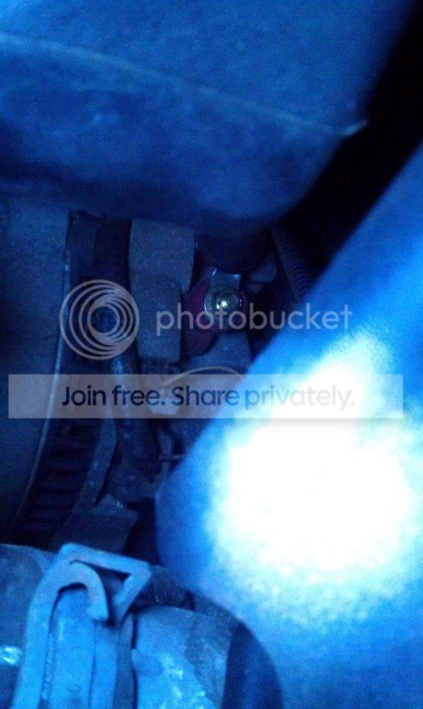

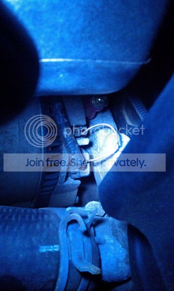

    This is assuming the alternator on 04-08 is close to the same setup as the 97-03
    But there should be 2 connectors to take loose.. pretty basic connector just lift the tab up and pull up..
    Then one wire with a rubber boot on it.. Push the rubber boot off and theres a nut you have to take off..

    thanks man! i didnt think about lifting that tab up...damnit! ima go try.
